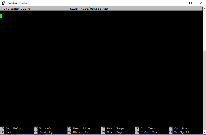

Postby Jan1959 » 27 Nov 2015, 17:25
See no lines to edit or to unmark

Postby hondagx35 » 27 Nov 2015, 17:47
Re: [BugFix] HiFiBerry DAC+ HW Volume (RuneAudio 0.3-beta)
Postby hondagx35 » 27 Nov 2015, 17:48
Hi Jan1959,
this is only valid for the PI2.
The file you have to edit is "/boot/config.txt"
Postby Jan1959 » 27 Nov 2015, 18:13
I have an XBMC-2B-HIFIBERRYY
Hifiberry + Bord1 x Rca
How should i enable the drivers

Postby hondagx35 » 27 Nov 2015, 18:23
Postby Jan1959 » 27 Nov 2015, 20:57
Frank, MPD says HifiBerry Dac+ :D
Thank you for your help. Tomorrow listing to the music with the hifiberry+
