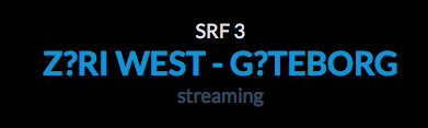

When I listen to one of my favorite radio stations, all songs with foreign characters are displayed incorrectly:
Bildschirmfoto 2017-04-19 um 13.10.22.png (13.85 KiB) Viewed 3275 times
The same song, streamed from the NAS, looks fine:
Bildschirmfoto 2017-04-19 um 13.12.48.png (11.9 KiB) Viewed 3275 times
Where do I start to debug this? Apparently the radio station uses a different character encoding than either the Runeaudio installation or the NAS. Can I specify this somewhere?
Thanks! Martin
