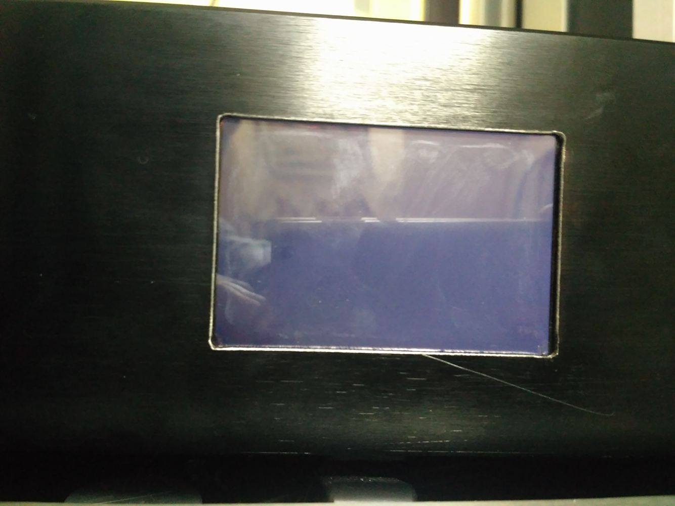

Postby mrhung751 » 02 Apr 2017, 13:09
I installed version 0.4
But the 3.5 "LCD screen is not installed.
Please help me where is the error?
mrhung751
Joined: 31 Mar 2017, 09:10

Postby hondagx35 » 02 Apr 2017, 22:04
Hi mrhung751,
you have to provide more info to get an answer here.
What brand and type?
Does it work with other versions (Rune)?
Rune Audio (on raspberry pi2/3) supports HDMI displays and the official 7" display.

Postby mrhung751 » 03 Apr 2017, 03:59
hi
I use waveshare 3.5 lcd. Rune audio 0.4.
I installed version 0.3 running normally. With version 0.4, the LCD only shows black. The web browser works normally.
