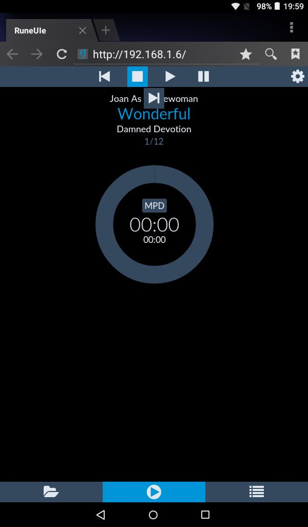

The forced hiding of the top/bottom menu bars when in landscape mode does not work too smoothly.
If the menu bars are displayed in portrait mode and the device is rotated, they are still displayed in landscape mode until a button is pressed or the page is refreshed - then they vanish. If the device is then rotated back to portrait mode, the menu bars remain hidden until the page is refreshed.
I think this behaviour might be a bit confusing. :?

Postby R101 » 22 Feb 2018, 18:38
Hi rern,
The top/bottom menu behaviour has not changed. The only difference now is that the repeat/random/etc buttons cannot be hidden.

Hi rern,
Using the Android browser, everything seems to work as it should in portrait mode.
If I refresh the browser in portrait mode, all is OK.
If I then rotate to landscape, there are no top/bottom menus.
If I then rotate back to portrait and then to landscape again, the t/b menus appear, but the top banner obscures the artist information.
If, instead of rotating back to portrait, I refresh the browser in landscape mode or swipe up, the t/b menus appear in the same way.
However, I do not think this is worth spending your time on, because everything now seems to work perfectly (after a long wait for connection) in the RuneAudio app. Even the left to right swipe works if it is made from middle to right edge.
