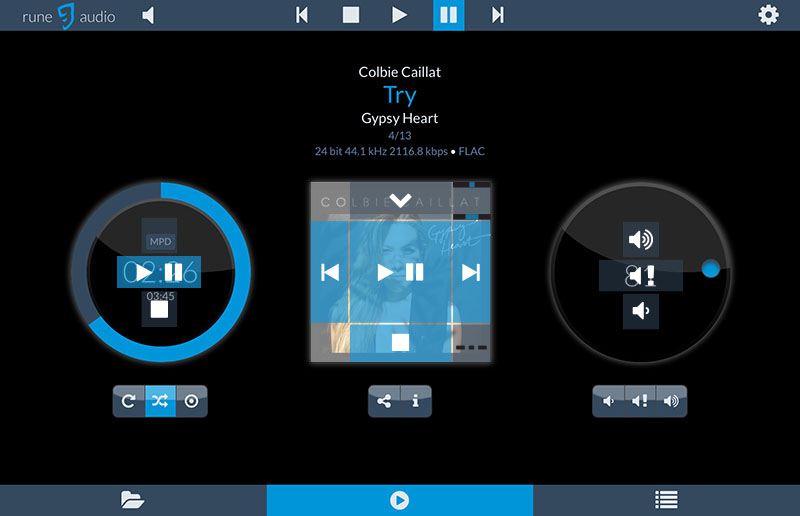

Here is the current controls.
The previous overlay guide may still be in browser cache. It takes a while to show the new one or you can clear browser cache.

Unfortunately the Play-button no longer works. It seems to be dead in every location on screen - the top bar, the centre zone of the album artwork, and the centre of the track timer-wheel. I've tried it both via PC browser (Chrome and Edge) and the Android app, all with the same results. I've tried flushing the browser cache, without success. The Play-button only works again if I uninstall RuneUI Enhancements and go back to the original UI. :cry:
As far as I can tell all the other buttons and album-art zones still work as expected or as shown in your screenshot.

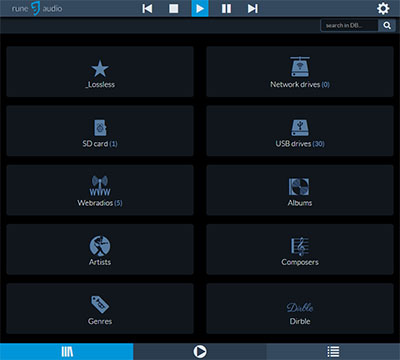

Improve icons and Webradio cover art:
Library icons:

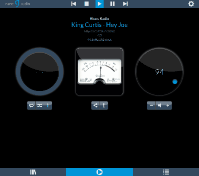

Most icons were improved.
Webradio cover art was replaced with animated VU meter.
