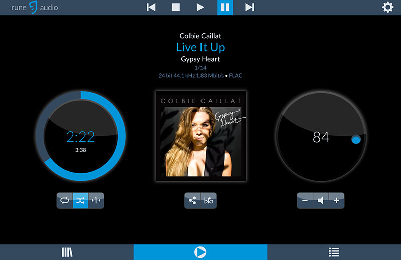

20180307 update - with the cover art as main control
(See animations in 1st post)
Postby rern » 20 Mar 2018, 11:24
A new look is coming.

Hi dror,
The web UI has been working fine for all browsers after MPD upgrade. It’s local browser, Midori, that needs upgrade along with MPD but behaves not well. It’s not broken but it consumes high CPU cycle all the time until you manually refresh it.
An alternative is Chromium which takes a little more time to load but reportedly works better.

Just a FYI if no one is aware of it.
If you click on the time in the middle of the countown circle
it will pause your music.
I find this is awesome on a phone or small form factor better
than the small play/pause button on top which can be hard to hit.

20180406 Update:
- Show sampling info, duration (for DSD as well) while stop
- Hide elapsed time while stop, leading 00:0 while play/pause
- Elapsed time changed along with time knob drag
- Enable tab/drag time knob while stop
- Enable previous/next song while stop, at fist/last goes to last/first
- Lower time knob refresh rate on local browser to lower CPU load
- Switch from countdown.js to normal setInterval()
- Fix long-press volume up/down
