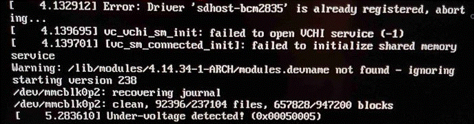

Help! Just Tried the new image but I get this on the splash screen. I got a rpi3B with a digiplus hat and a HDD attached to it and it is connected to my router. Used Rune 0.4 before without problems. inserted a screen capture of the error message.
splash screen (2).gif (67.3 KiB) Viewed 5619 times
