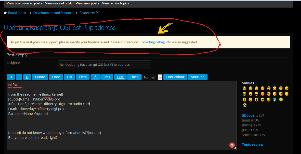

Postby hondagx35 » 06 Oct 2017, 09:39
Hi foxint,
did you reboot after setting the I2S driver?
And for the very last time:
No debug information => no support!
Select the driver on the settings page, reboot and send the debug info.

Postby hondagx35 » 06 Oct 2017, 09:56

Postby hondagx35 » 06 Oct 2017, 10:38
