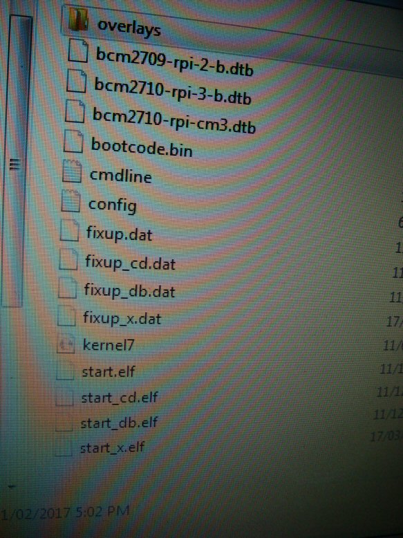

Hi Frank
I cannot find:
/boot/config.txt
Here is photo
foxint
Posts: 181
Joined: 29 Mar 2016, 06:36
Re: Updating Raspian (pi OS) lost Pi ip address
Postby hondagx35 » 06 Oct 2017, 12:02
Postby foxint » 06 Oct 2017, 12:11
Sorry, I was confused as I was given the Pro Manual…so I thought it was a pro…I did not know until now there were 2.
I do have noise/music from the internet radio…. great THANK YOU.
