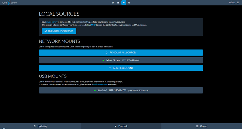

Hi emilot,
i bet you did the following:
- shutdown your pi with usb stick mounted
- remove the usb stick
- restart your pi
At the current stage this is not possible.
This behavior will be improved / changed in the future.
So what can you do:
- mount your stick a second time and remove it the "correct" way
- delete the associated folder under /mnt/MPD/USB/
