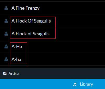

Postby trumpy81 » 09 Oct 2016, 22:12
Frank, I made the change as you specified but unfortunately it was not entirely successful.
As can be seen in the attached image, there are a few artists that are duplicated with slightly different spellings. Those spelling errors were corrected in the file names and tags but they remain in the Rune Audio database.
I rescanned twice just to make sure, each scan takes approx. 45mins.
I also noticed that it does a quick scan when first booted but that only lasts a few seconds.
Any ideas?

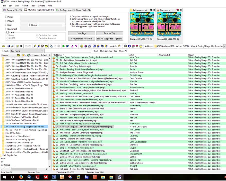

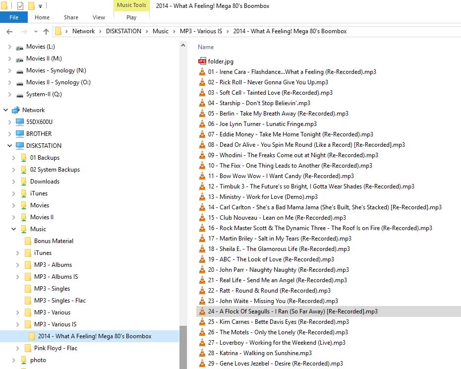

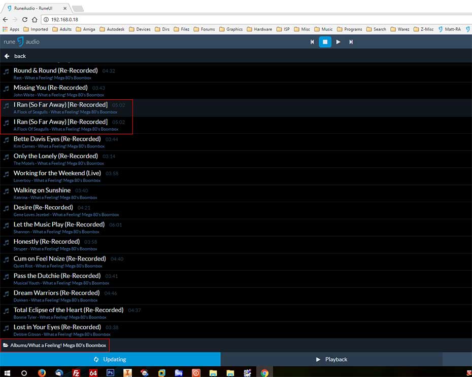

With all due respect, I do know how to check a tag and maintain a filesystem. Hopefully, the images below will demonstrate the issue.
Image 1 shows one of the offending files in File Explorer. Notice the address bar as the file is stored on my NAS which happens to be named DISKSTATION. You will also notice that the file name has been corrected.
Image 2 shows the same file opened in Tag&Rename. The file name has been corrected and the Artist tag has also been corrected.
Image 3 shows the same file within RuneAudio. You will notice the album name at the bottom and the dual entries that show that the corrected file has been added, but the incorrect file entry has NOT been deleted. So Frank's solution has partially worked, but for some reason it has not removed the old entry. This applies to several other files, some that had a file name change as well as a tag change and some that simply had a tag change.

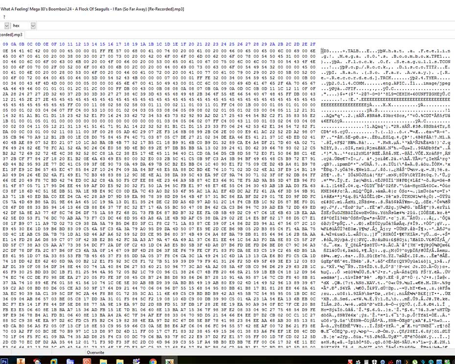

Postby trumpy81 » 10 Oct 2016, 06:28
This image shows the same file open in a Hex Editor and hopefully you can pick out the IDv3 tag at the beginning of the file. It also shows the corrected tag. You will also notice the file address at the top of the window.
I will also note that I made a further update to the MPD database before taking these screenshots.
I have also run the files through mp3Checker and all passed the test, so it is not a faulty file at fault here either.
