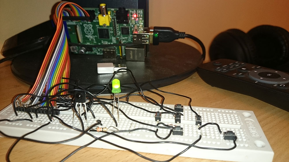

How about this page? It's the record of my trial.
Sorry for incomplete English, and somewhat incomplete description.
But I can successfully use an IR remote controller with a very cheap (ca. $1) additional hardware.
