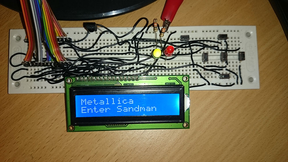

In the meantime, I went a little further with GPIO and added LCD display with keys. I'll write tutorial and give code probably on my site and then give it here on forum.
