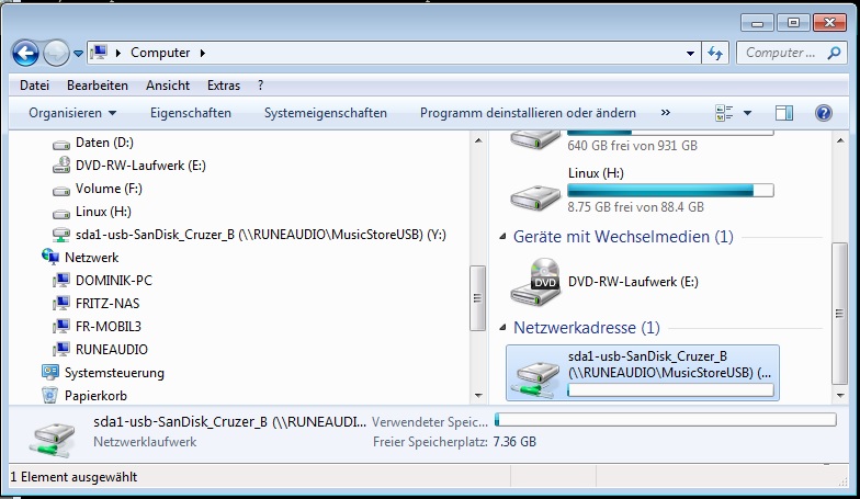

If I change the share path from
[MusicStoreUSB]
path = /mnt/MPD/USB
to
[MusicStoreUSB]
path = /mnt/MPD/USB/MUSIC
I get the correct size, 160GB.
So this issue is sort of "partially solved", but this is not a flexible solution in this form.

Reformatted the disk to FAT32 again on my Mac, connected it to the Hifiberry, now all works.
Size reported for the USB smb share is 160GB as it should.
I can copy files of any size.
The only issue is the "fixed" configuration regarding the disk path name.
The smb share path must be directed to the disk mount point itself, not to the parent USB folder.
The parent USB folder belongs to the SD file system, hence the small size limit.
So the issue is partially SOLVED.
