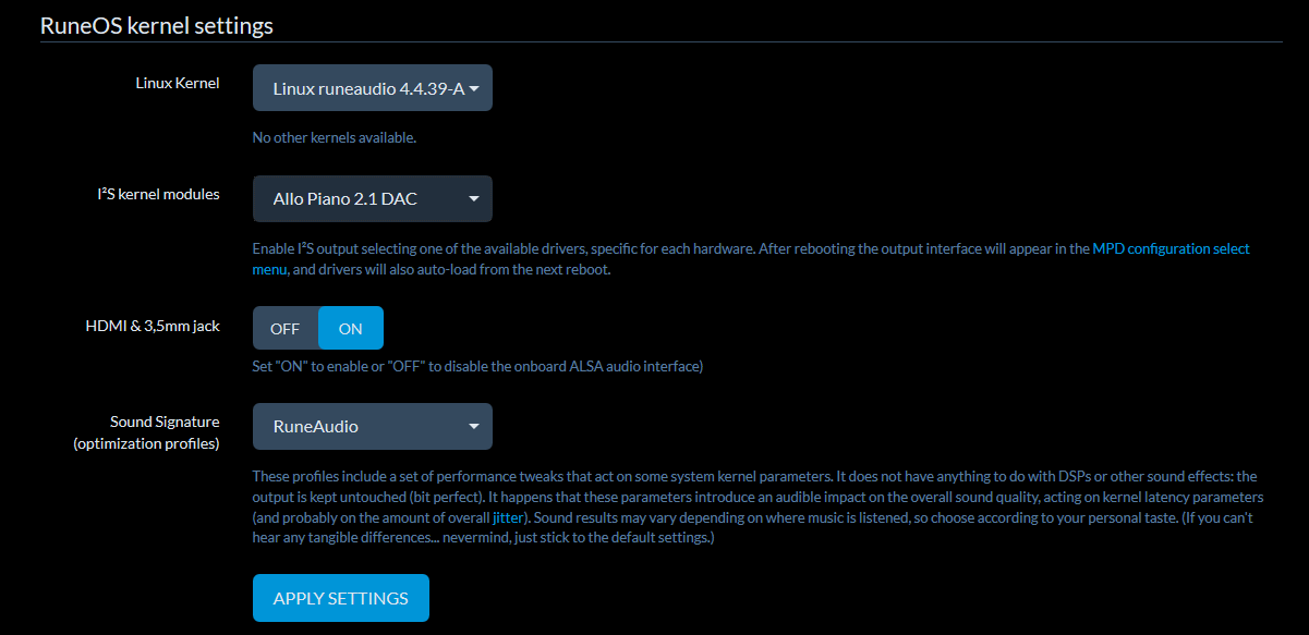

I have flashed a new SD card with the latest 0.4 beta from Frank on a Raspberry PI 2B. This works Ok UNTIL I make any changes (other than changing the time zone) on the Settings page. At this point the ALSA mixer seems to get removed and I loose all ability to output audio from the 3.5mm Audio Jack., on the MPD / Audio Output Interface it says 'Nothing to Select'. I am not using a DAC and simply want to use the analog audio output.

The HDMI and 3.5mm Jack setting IS enabled but still no analog output. I am away from home until later in the week but will try the config.txt option when I get home.

Adding:
## RuneAudio HDMI & 3,5mm jack
dtparam=audio=on
to the config.txt file and rebooting solved my issue. I now have the 3.5mm jack working again.
