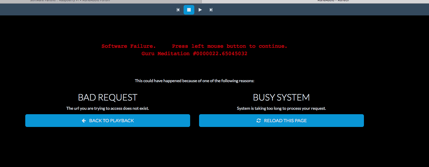

Hello.
I have just downloaded this software to give it a try on a Pi 2, I have purchased a superfast microssd card and installed with windiskimager.
It boots up fine and I currently have it plugged into a screen where I can see the interface
However if I try to go to it via a browser I get a big ugly flashing sign telling me: Software Failure.Press left mouse button to continue.
Guru Meditation #0000022.65045032.
This is on Safari, in OSX
On chrome OSX its fine, and on iphone and surface its fine, so I am guessing an incompatibility with safari, which of course I use the most!
Is there a work around?

Postby garethsnaim » 22 Apr 2016, 11:04
I am connecting to the right IP the software failure bit is in the rune interface, plus its the same IP I am using on other devices
Rune and Safari don't like each other it would appear

Postby garethsnaim » 22 Apr 2016, 14:13
I genuinely have no idea what you are on about regarding URLs, I don't need a URL I know the IP. The IP on any other browser and device works but not on safari.
I have been playing all afternoon with Rune. I love the interface however I suspect that Raspberry PI is not really up to the task. Its been scanning literally all day on the music files of which there is not tonnes, it seems to have bummed out at around M, no amount of cajoling will get it to do any more scanning although it says it is updating.
But I guess the main issue for me is no album artwork until the album is playing, I can understand the pressures this probably puts on a little PI, but still its a something I cannot do without.
Its nice but not for me, so I'll bump back to Daphile for now. I'll possibly get the PI 3 and see how that goes.
