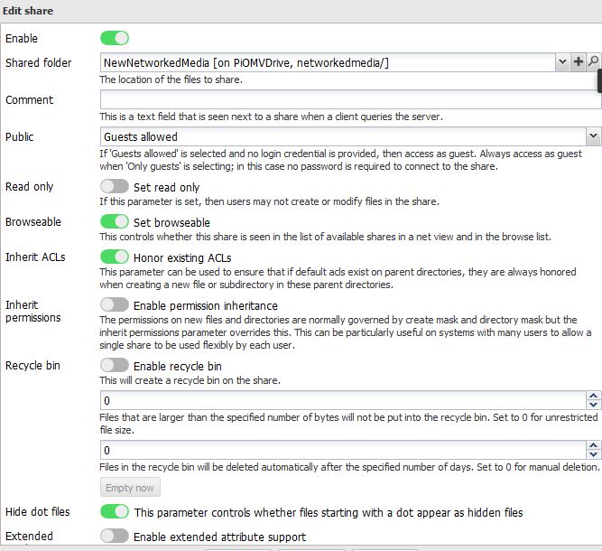

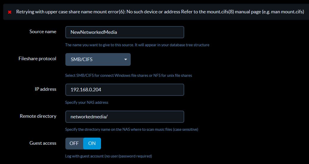

I'm baaaaccckk... with another stupid problem that hopefully you can solve. I've been enjoying the convenience of Rune on my Pi playing back my hires audio and ripped mp3 files of all my CDs so much that I thought I'd branch out, buy another Pi and install OMV (NAS software) on it along w/ a 2tb USB HD, throw all of my files on THAT, including video files, and be able to access all of my collection on the Rune and on our two Rokus. It worked great.. with the two rokus. I even managed to get the NAS mounted to Rune on the first try. The catch is, after the test run, I powered down the OMV Pi, removed the HD so I could transfer the bulk of my files to it directly from my laptop, did the transfer, reconnected the drive to the OMV Pi, powered it up, made sure the same folders were shared both in general and via SMB/CIFS, and then .. nothing. The RunePi won't connect to it. I've attached screenshots; two are of configuration screens in the GUI of OMV, and the third show what I typed into the NAS mount portion of Rune. The IP address is correct; that's what I use to access the GUI for OMV, much as I use a similar one for the RunePI (both static).
Any ideas what's going wrong or what I've missed? Like I said, it worked flawlessly and easily the first time, and I have no idea what's changed. The file system on the USB HD is NTFS, but that hasn't changed, either. I'm pretty sure that the OMV side of things is configured correclty because I CAN access that NAS and associated folders from my win7 laptop now. The Rokus use a DLNA server addon to OMV, but that's working fine too.

your second picture shows the shared folder name as "NewNetworkedMedia".
Linux is case sensitive, so please type it exactly like shown and without any slash at the end.

Thanks for the quick reply, Frank. I tried what you suggested to no avail. OMV's naming protocols are a little weird; it has you give a shared folder a name when you create it, but that name doesn't have to the same as the actual path name. I ran into some problems with OMV, and that may or may not be the cause.. hard to describe, but I'll try.
I had originally setup a folder called "NetworkedMedia" with the path networkedmedia/ . The first time I removed the USB HD from the OMVPi to add some files to it, for some reason the shared folder no longer registered the drive (you can see the "n/a" in one of the attached screenshots). I couldn't delete it because it was "referenced," whatever that means. My workaround was to create a new shared folder name, "NewNetworkedMedia," that points to the same path, networkedmedia/ . You can see that in the small strip-like screenshot in my first post.
The ...... NEVER MIND!! I just caught it.. I had been typing "NewNetworkMedia" instead of "NewNetworkedMedia." Holy crap. I've wasted about 8 hours of my time and now some of yours on this. I am SO sorry.....
It's up and running. Words can not express my disappointment in myself.
