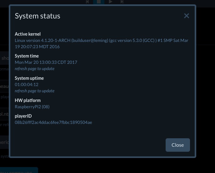

Yes, I was thinking that it might be a wifi issue also. I have changed the channel my wifi is broadcasting on, to one that a neighbor isn't slightly interfering with. Also tried moving the device to a more exposed location. I'm one floor above the router/access point, almost directly above it, and am getting a strong signal according to the wifi set up page.
I also reinstalled the older version, v0.3-beta (23/03/2016). Still getting locked out.
I did notice in the status screen this -
Screen Shot 2017-03-20 at 1.01.36 PM.jpg (53.1 KiB) Viewed 2414 times
I'm surprised that it's reporting a Raspberry Pi2, because as far as I know I have a 3B.

Postby hondagx35 » 20 Mar 2017, 21:44
