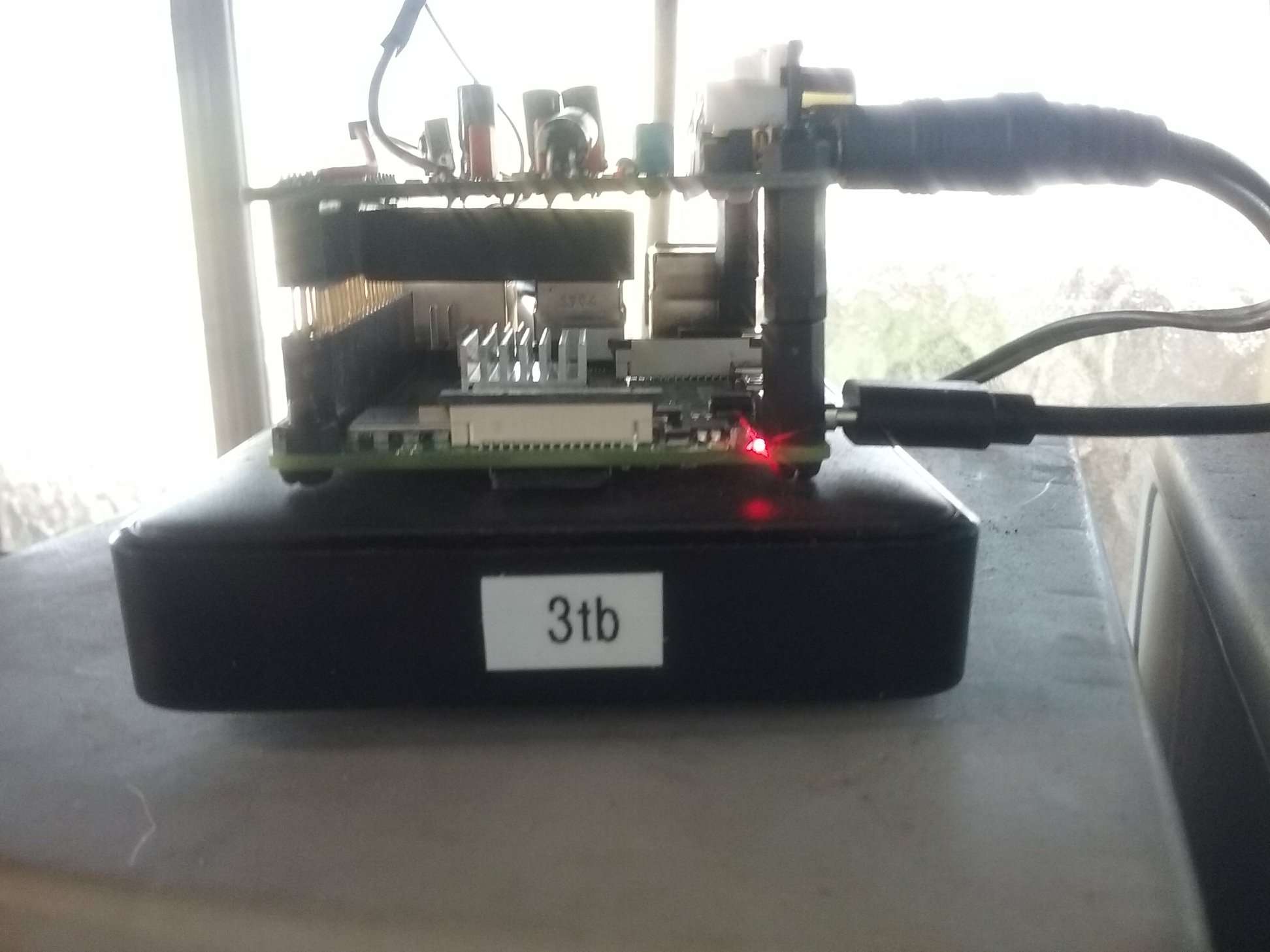

It's amazing how much faster PI4 is especially booting to a system installed on an SSD drive on the USB 3.0

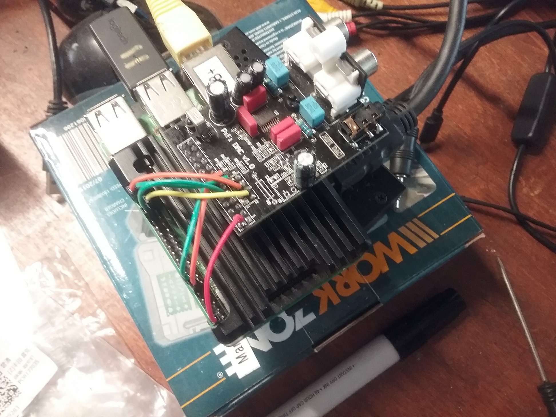

I have a metal pi4 case coming and a better fan, I am running the 5v fan on 3.3v which makes it nice and quiet and the idle temp is around 35C unlike the 65C+ when I first got it. I will post some pics when I finish setting it up. I am going to use double sided tape to stick the drive to the bottom of the case.
I have added a riser to the pi 4 to lift up the PiFi hat so that I could put a 5v fan in under the PiFi hat and I connected it to the 3.3v so it runs quieter.
I have ordered an Aluminium heatsink case for the pi 4 after experiment with different cooling methods.
I have one on a pi 4 Kodi setup I use on my TV and it keeps it below 50C with no fans running.

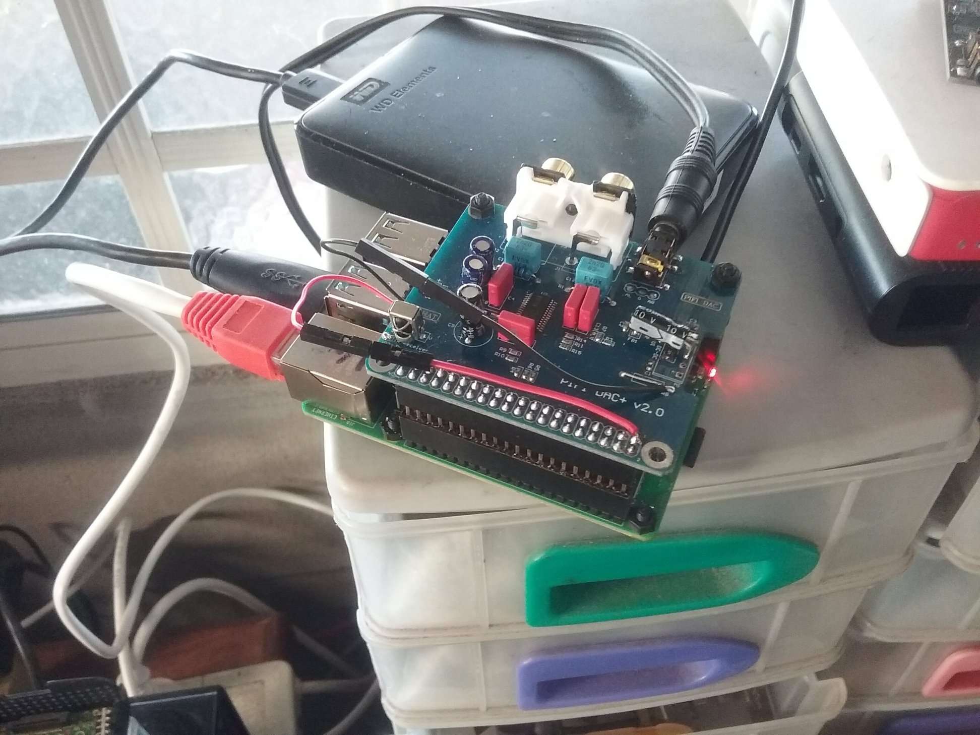

I also repaired a PiFi Dac v1 that I thought I had broken and it is running on a rpi 3b+.
For those interested I modified the Pifi's to eliminate the unnecessary conversion of 5v to 5v.
Look here for instructions: https://www.webx.dk/oz2cpu/raspberry_pl ... i_mods.htm
