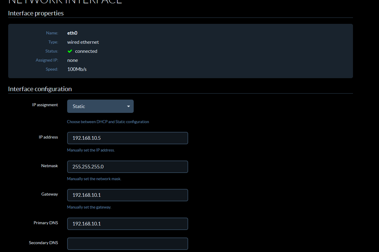

I have a new Raspberry Pi 3 as my Pi2 NIC died. I am running the Hifi Berry Dac + with it.
I have a hardwired connection to the Pi3 now and have it setup with a static IP and have that IP configured in local DNS on my firewall. I also have the WLAN configured with a static IP address and DNS updated as well on the firewall.

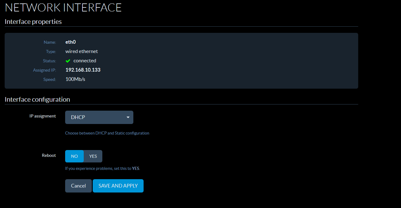

I can access the RPI3 via WLAN, but not LAN. Once in the setting menu the LAN is showing connected, but no IP address. The IP address assigned is unique. If I set the LAN to DHCP it works without issue.
I am running rune beta .3
Pics attached. Static doesnt show subnet, gateway, etc., but they are all identical for both DHCP and Static configurations.

Definitely nothing wrong with the network. Static IP's work on every single device (3 laptops, 2 desktop PC's, Smart TV, 4 tablets, 2 Smart phones, Xbox, and NAS).
If it works with DHCP its not the NIC itself and based on the info above its also not the network which leads me to believe I may have discovered an issue in the OS.
I have looked through my firewall logs and nothing is being flagged as blocked on that host name either.
