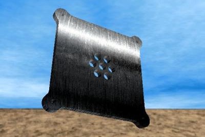

I am going to try to fit a standard 2.5" drive into a stacked enclosure with a Pi 2, the DAC+ or DIGI+, and a GPIO expansion board (for an encoder or volume control pot). I did that on an earlier project, and it turned out ok. The stack plate outline I want to use will look something like this:
DAC stack plate

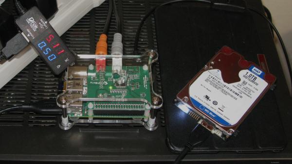

In the meantime, Pi, DAC+, two dongles, 1 Tb disk drive, running fine for two days, with frequent restarts... As you said, no problems when using a good supply, :D You can see the dongle I use to monitor current and voltage in the corner of the pic. (To make better measurements, I use a Fluke 115).

Postby johnbanks » 26 Mar 2016, 16:18
PeteB ...
What is the gizmo that's showing 5.11 V and 0.50 A in the photo?
