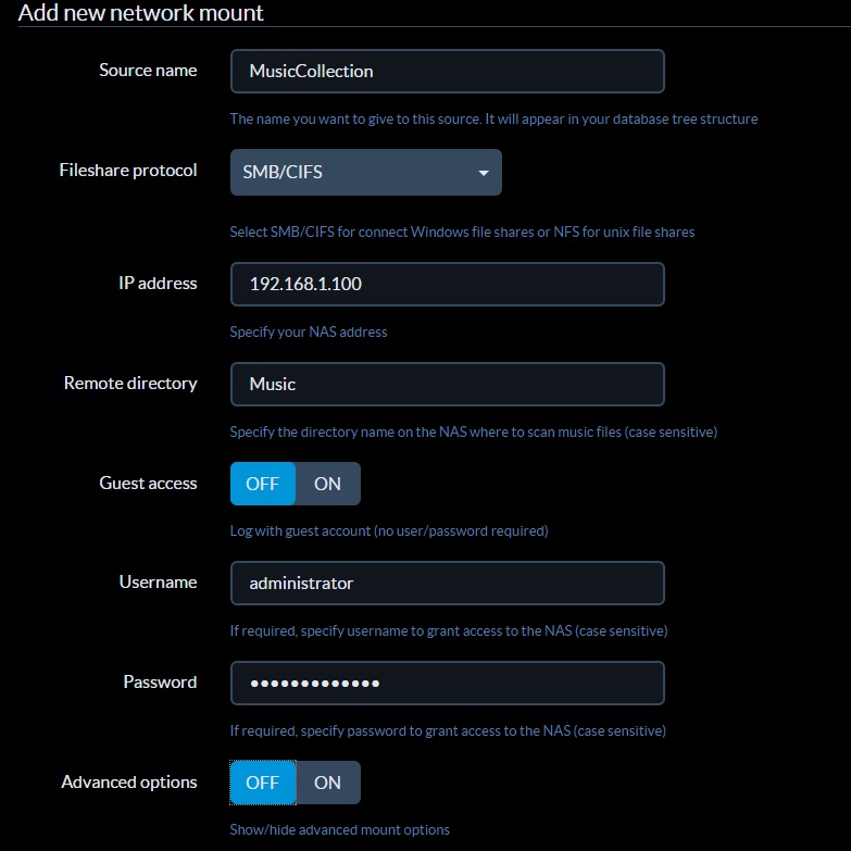

Hi hondagx35,
Thanks for the response. I've set the NAS Mounts as follows:
Source name: MusicCollection
Fileshare Protocol: SMB/CIFS
IP Address: 192.168.1.100
Remote Directory: Music
Guest Access: Off (also tried on)
Username: administrator
Password: mypassword
Advanced Options: Off and not configured
Luke
ln_willo
Joined: 30 Dec 2014, 08:27
Re: Problems creating SMB mount
Postby hondagx35 » 05 Jan 2015, 17:39
Hi Luke,
your settings look fine.
In conjunction with the error message starting with "sh: ,sec .." i believe there is something wrong with your password.
Does your password end with "sh:"?
If your password contains special characters (like space, colon), please try an other one or put it in double quotes.
frank
Postby ln_willo » 06 Jan 2015, 11:01
My password did contain special characters. I created a secondary restricted account with a simple password and it connected perfectly.
Thanks for your help on this one mate. Much appreciated.
