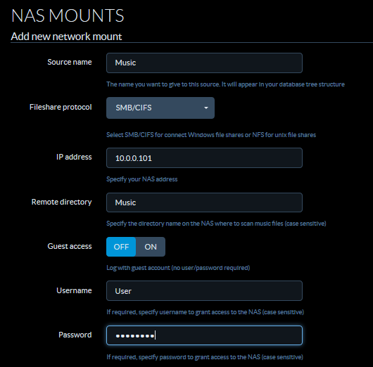

Hi Alan,
please try:
* IP address
192.168.1.xxx (IP address PC)
* Remote directory
Music
* Guest access
tur this off and use your user and password from your PC

Postby hondagx35 » 13 Dec 2016, 21:52
please try this
http://kodi.wiki/index.php?title=SMB%2F ... dification
With user and password it should look like this
Without user and password leave the guest access on.
