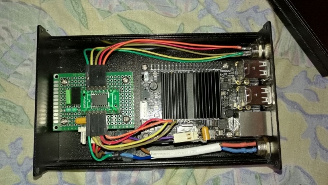

When i collect c2 to my diy Tda1543 with i2s , the sound is small and noisy. After that I add the I2s buffer.the sound become normal and work prefect.
