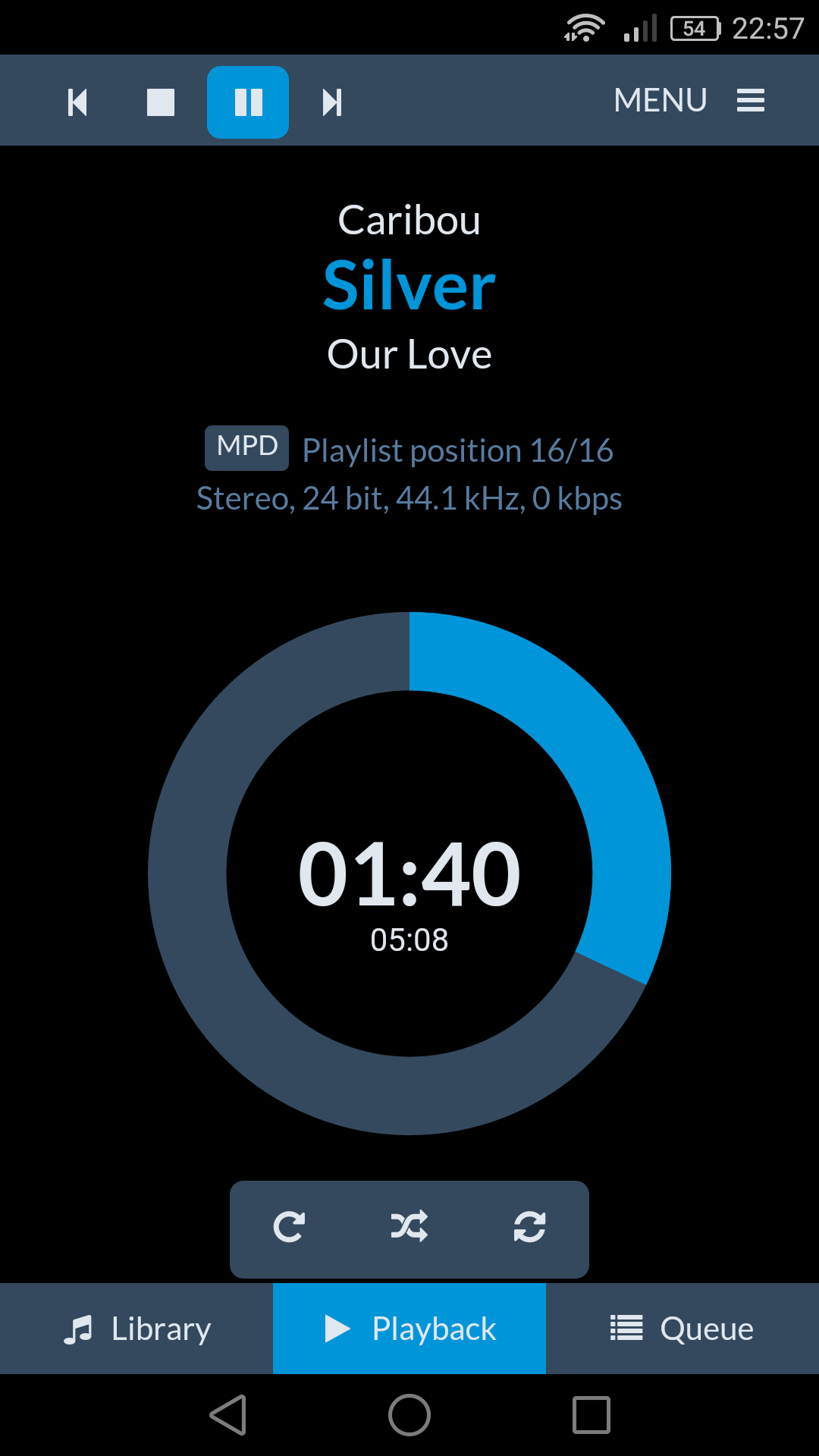

Postby bronax » 30 Aug 2016, 21:59
It looks like a freeze, i Can push on the stop and pause button but no reaction cause i have no song, and naturally the play button is not available as if the song was running

Postby bronax » 02 Sep 2016, 07:47
yes this is the Android app, I also tried from the Webinterface.
After testing and testing yesterday, I think my NAS is ok, cause when i select the Jack Audio Output connected direct to my amp, everything is playing fine.
It's very strrange, cause i didn't touch anything and everything was playing fine before.
The DAC is a Pro Ject BOX connected per USB, I'm waiting for a SPDIF card, to connect my DAC through coaxial cable.... we will see.
I try with Volumio, same problem... (by the way rune is much better :) )
