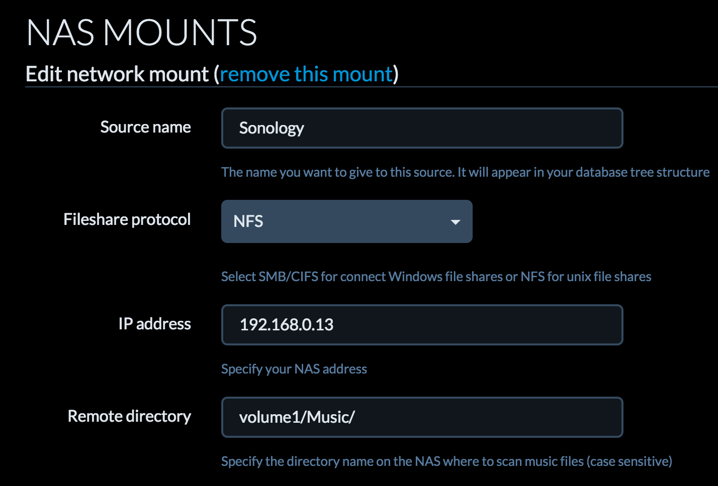

Postby vinh » 27 Feb 2015, 07:59
Hi Lendrix68,
There is my setup, it might help.
Don't for get to check you Synology NFS sharing folder with permission and your Pi's ip.
The mine is in DSM 5.1

Re: Mounting Synology NAS
Postby mamekedi » 28 Feb 2015, 06:54
Hello Lendrix68,
don't forget the forward slash at the end of your patch
my is like:
MyData/MaMeKeDi_Music/

Postby Lendrix68 » 02 Mar 2015, 08:07
Thanks all for your help apparently it was a simple / missing
