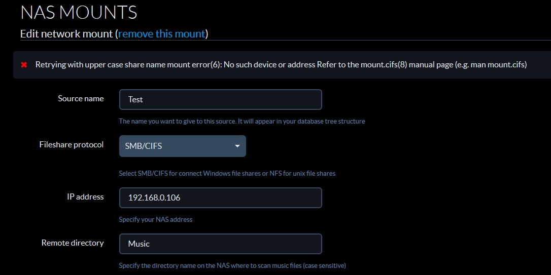

Postby TheKingOfChaos » 17 Feb 2015, 20:56
I have mount the share and i am not getting any errors
Mount

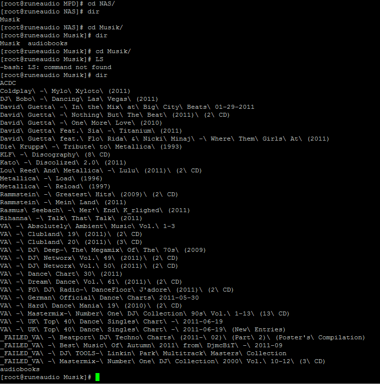

Billed 4.PNG (5.78 KiB) Viewed 1580 times
as you can se in this picture i can browse the filshare by ssh
but files is not shoing up in runeAudio is there a way to debug the database update

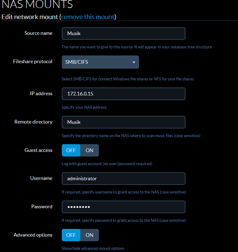

Billed 3.PNG (56.4 KiB) Viewed 1580 times

Postby TheKingOfChaos » 21 Feb 2015, 10:08
i found the problem i disable the ffmpeg and now it is working
