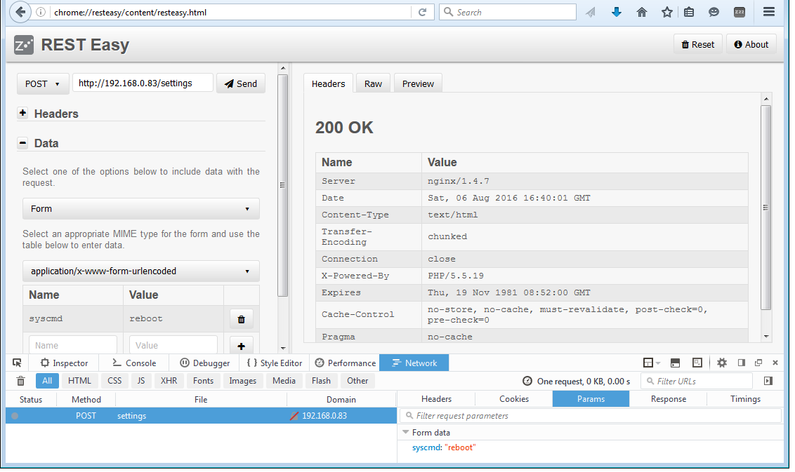

Postby deenski » 06 Aug 2016, 16:30

Re: HTTP Request to power down Raspberry PI
Postby hondagx35 » 06 Aug 2016, 17:50

Postby hondagx35 » 30 Jun 2020, 22:24
an HTTP POST request cannot be sent by using just an URL. (Except for the special case that there are no form fields and that the server doesn't care about the Content-type header.)
What is your intention?
