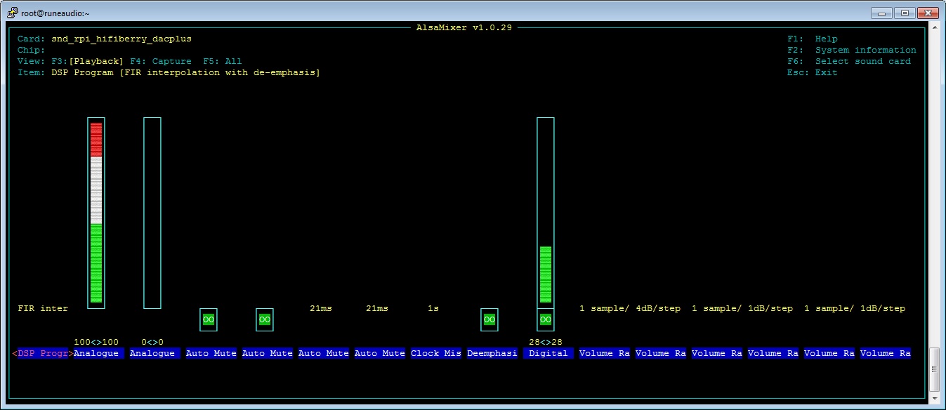

This does not work for me with clean/new image. Either I get fixed volume when hardware is selected or I can have variable volume with software. Aplay -l identifies the card and I do have sound. It is a pcm5122 card and i2c is its interface.

For my setup:
# cat /proc/asound/cards
0 [ALSA ]: bcm2835 - bcm2835 ALSA
bcm2835 ALSA
1 [IQaudIODAC ]: IQaudIODAC - IQaudIODAC
IQaudIODAC
2 [Camera ]: USB-Audio - USB2.0 1.3MP UVC Camera
USB2.0 1.3MP UVC Camera at usb-bcm2708_usb-1.4, high speed
From Alsamixer I select f6 : and then the card: IQaudIODAC I can select 'Digital' but cannot make increase/decrease like I can PCM and Playback.
Keith

Thanks for the help. This used to work. I do not know what is going on. The only difference I can think of is that I am now on a wire instead of wifi. I updated the runeUI by git pull according to the other thread and still nothing. What I have is my own board which is a PCM5122 connected like an IQAudio. I get nothing when I try to use the HiFiBerryDAC+ (selected in /boot/config.txt) which uses the same chip (And I think it is connected the same way) and do not know why. Is the driver aware of any eeprom with config variables n it?I have tested this card on a Pi2 and a B+ and, like I said, it worked before, but doesn't now. It was noticeably clearer with Hardware volume control and I had almost nothing below 50% and all control was between 50 and 100%.
When I type that redis-cli command, the UI does go look like it is changing. When it goes to 'hardware', the volume goes to full volume and I cannot adjust volume from the UI. I can click a value, but it immediately goes to 0 in the UI. I can adjust volume by my up/dn keys from the terminal running alsamixer and adjusting "PCM". Digital always shows 0.
Any help?
