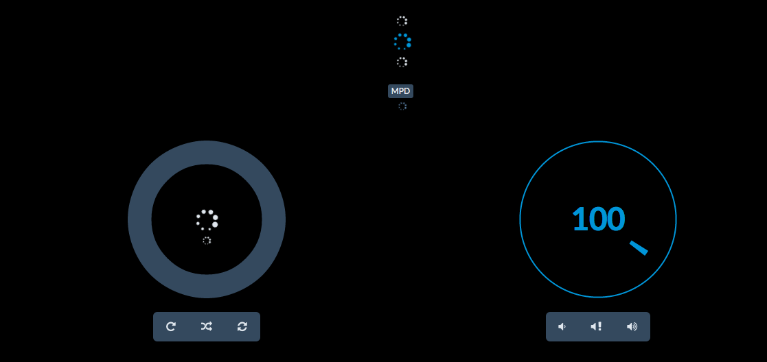

Postby anfuca » 08 Nov 2015, 13:14
Thanks for your answer.
I've changed the port 80 to another in that file.
-Reboot.
-Now RuneAudio is running in the new port IP:Port to access to it.
-But it isn't working (take a look at the screenshot attached).
It seems that I should change the port in other place... but where?
Thanks!
