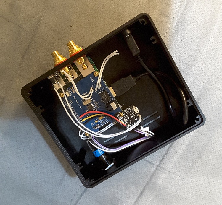

Hi Friends,
I have just made a box similar to this link (photos to follow). I intended to use RuneAudio UI , but I have difficulties to configure the UI to read the GPIOs, the Digi+ and the Pwr Mgt Module. Can anyone so nice help?
I even have a problem with my keyboard (I use US keyboard, but the default UI keyboard layout is different), how to change to match?
Thank you in advance.
Regards,
Charles

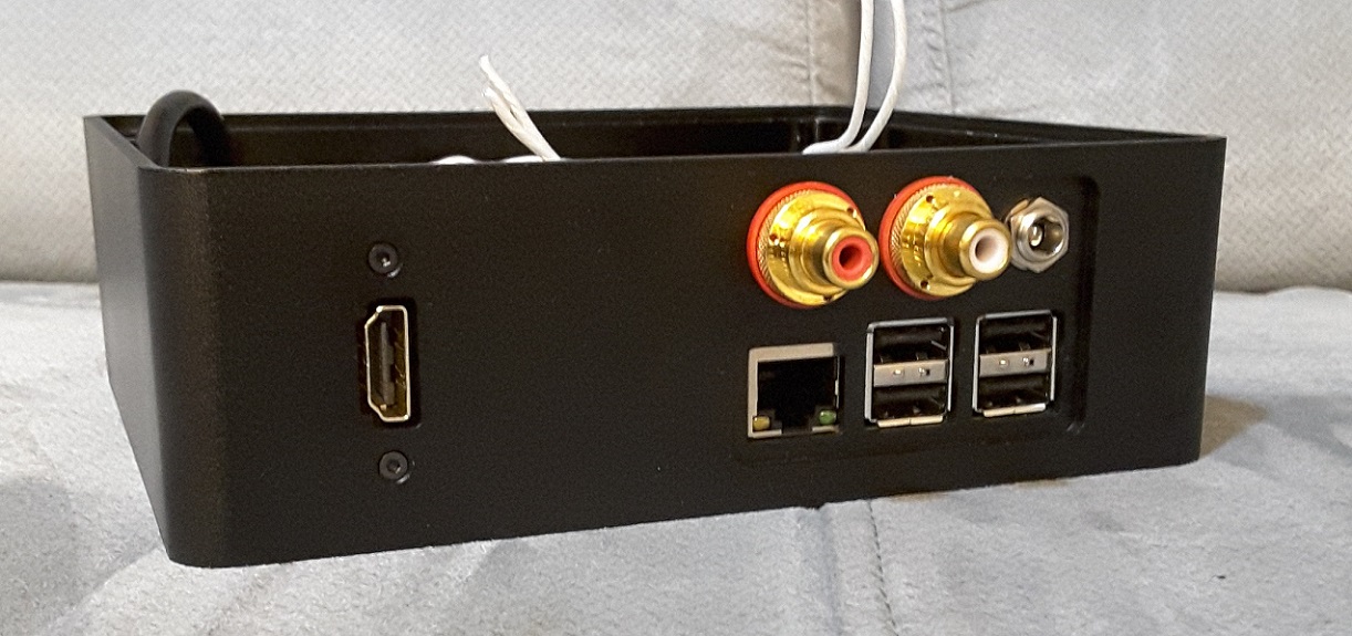

I have checked all wiring and is correct. This is the back view.

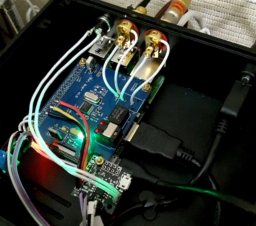

Re: AUDIOPHONICS RaspDIGI LTE HIFI Streamer Raspberry Pi 2 S
Postby charles6680 » 16 Jun 2016, 17:13
Present inside look. All wires connected.
