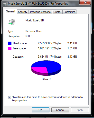

I have a new 3tb WD Elements USB 3 drive that I cannot copy files to over 1gb to as it says it is out of space.
In RuneAudio debug report it is correctly seen as 3tb (2.8tb used and 1.1tb free) and when I go in with Putty everything is fine to.
However from my Win 7 pc when I map the shared drive to my PC it reports as being 3.43 gb size with 1.01 gb free and 2.41gb used.
It is misreporting the size by roughly dividing by 1,000 as it is actually 2.8tb
win7 network drive properties
3tb drive wrong size.png (41.37 KiB) Viewed 2659 times
WTF is going on!

Thanks for that pointer, such a simple fix, DOH!
I found a post on a raspberry pi site and all you have to do is edit the Samba share path used by the drive to be the drive mount folder not the folder tree above where it is mounted otherwise it uses the SDcard size. What a weird glitch.
No need to worry about the size of you SDcard, I am using a 8gb but I did not realise that it was not automatically expanded on install.
So I changed this :
[MusicStoreUSB]
comment = MPD MusicStore (/mnt/MPD/USB)
path = /mnt/MPD/USB/
to this:
[MusicStoreUSB]
path = /mnt/MPD/USB/MEDIA-3tb
MEDIA-3tb is the actuall mount point of the usb drive.
Thanks again for your help, janui. All good now I have my 3gb space back.
