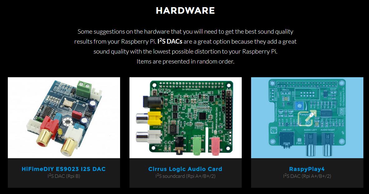

It was not a real decision by me - I just looked for a shop where I can buy a Pi3 and anything else needed.
I looked for DACs based on that suggestion:
2016-05-22 09_04_08-Turn your Raspberry Pi into a music player.jpg (104.74 KiB) Viewed 2125 times
so exactly that Cirrus Card I bought (you are right).
I suspected that I have to send it back and look for another card, so I'm very happy about your post.
It would be great if you could help me.
