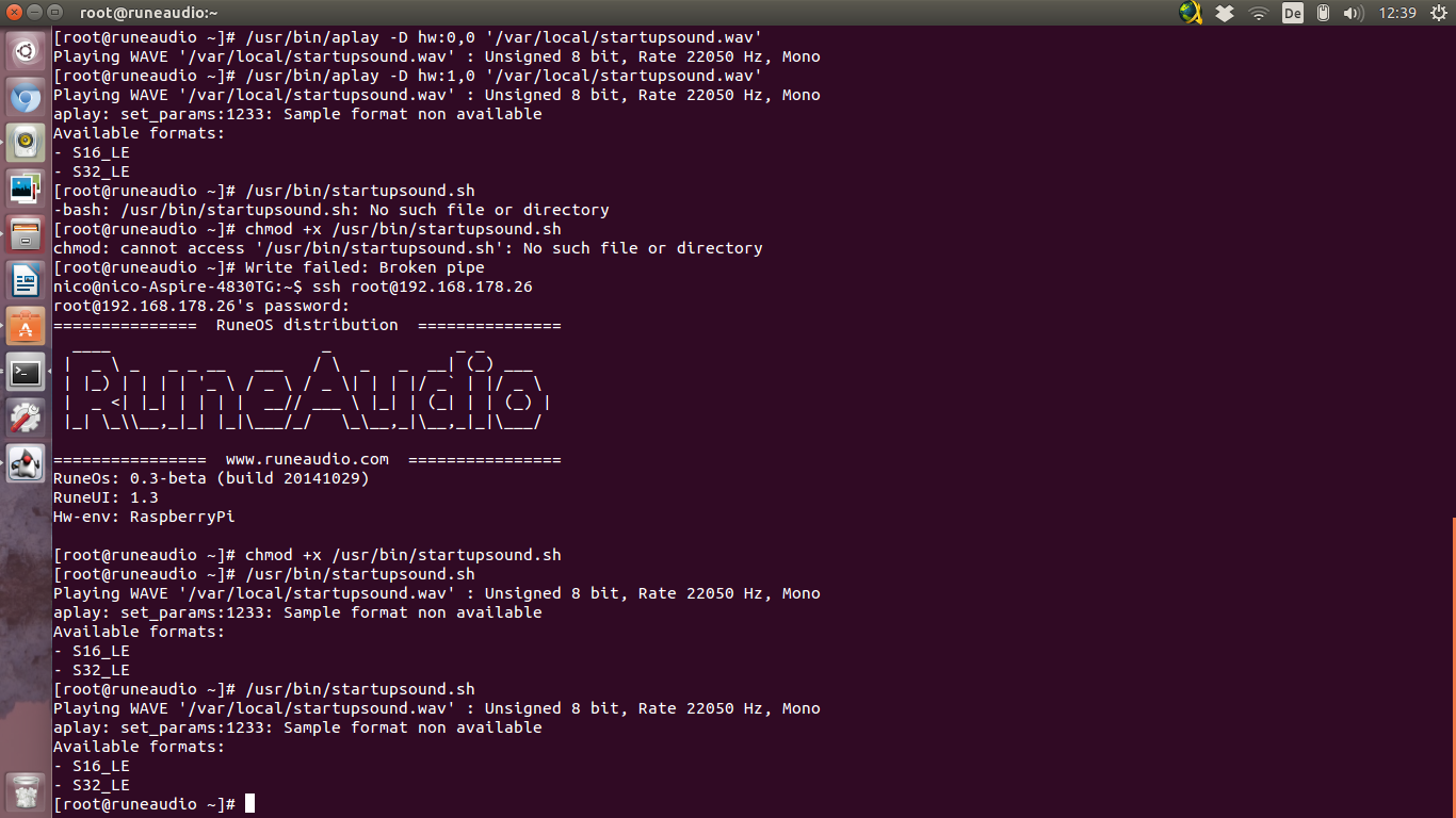

Postby Plugs » 26 Dec 2014, 12:41
Thx for your Nice Guide. But i get a error message.
is my wav sound wrong?

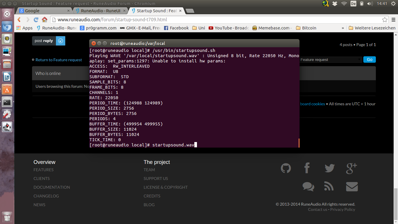

Postby Plugs » 26 Dec 2014, 14:41
This is what i get now.

Postby ACX » 26 Dec 2014, 16:55
It would be simplier to convert that file to a newer. wav (or even .mp3) with the standard 16bit stereo at 44.1kHz format.
