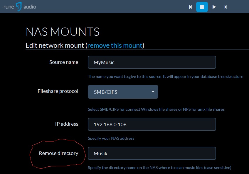

Postby hondagx35 » 04 Mar 2016, 18:57
Hi colito,
welcome to RuneAudio.
You have to enter your settings like shown here:
Remote directory is the name of your shared folder.
By right clicking on the folder and selecting properties you can configure the share or search for the name.
Did you watch the youtube video i linked above?
