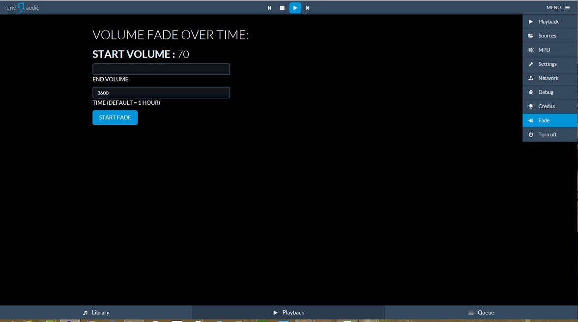

for you have been following my blog and postings will see that I have been looking at creating a player that will enable me to fade/slide volume over time. I have now written a function that enables you to do just that. Following my logic, you can also add additional screens/functions into RuneAudio. I will be looking at changing to a specific playlist at a pre-specified time.
Here is the screenshot:
Screenshot
Here is the instructions (first by hand if you want to see the logic) then automated with the attached tar file:

this MOD won't work anymore with RuneAudio 0.4. and the RP2 image.
Please edit the file /srv/http/app/templates/fade.php so it uses sysCmd and sysCmdAsync instead of shell_exec, see also .
