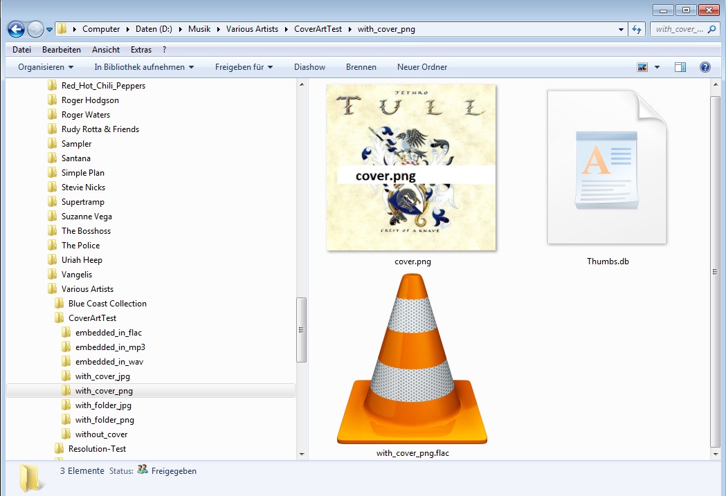

Postby hondagx35 » 26 Feb 2017, 18:09
Hi Arthur,
what version and device do you use?
RuneAudio searches for cover art in this order:
1. try to find embedded cover art
2. try to find local cover art (folder.jpg / cover.jpg / folder.png / cover.png)
3.0 try to find cover art on Last.FM (Album)
3.1 try to find cover art on Last.FM (Artist)
4. serve DEFAULT rune-cover image
To skip 1. you have to comment out
