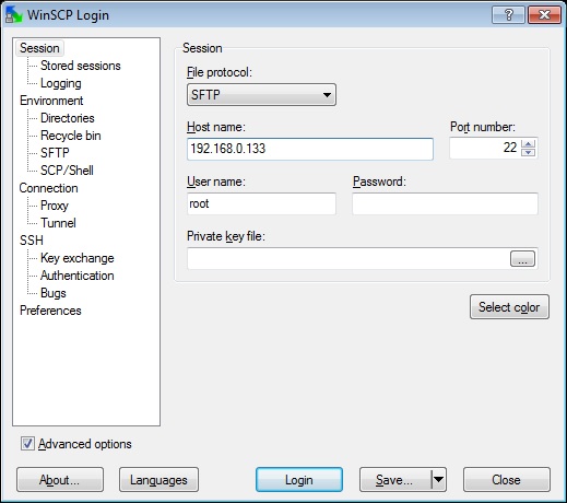

Hi rasti,
SFTP works out of the box on all RuneAudio platforms.
I use WinSCP without any problems.

I installed WINSCP and it works.
At least in the directories on the SD card.
The USB is only visible to me but I cannot write files to (I get error code 4)
Owner of these fies is MPD and I FTPd as user root, so
probably a user right problem....any quick fix for that ?
