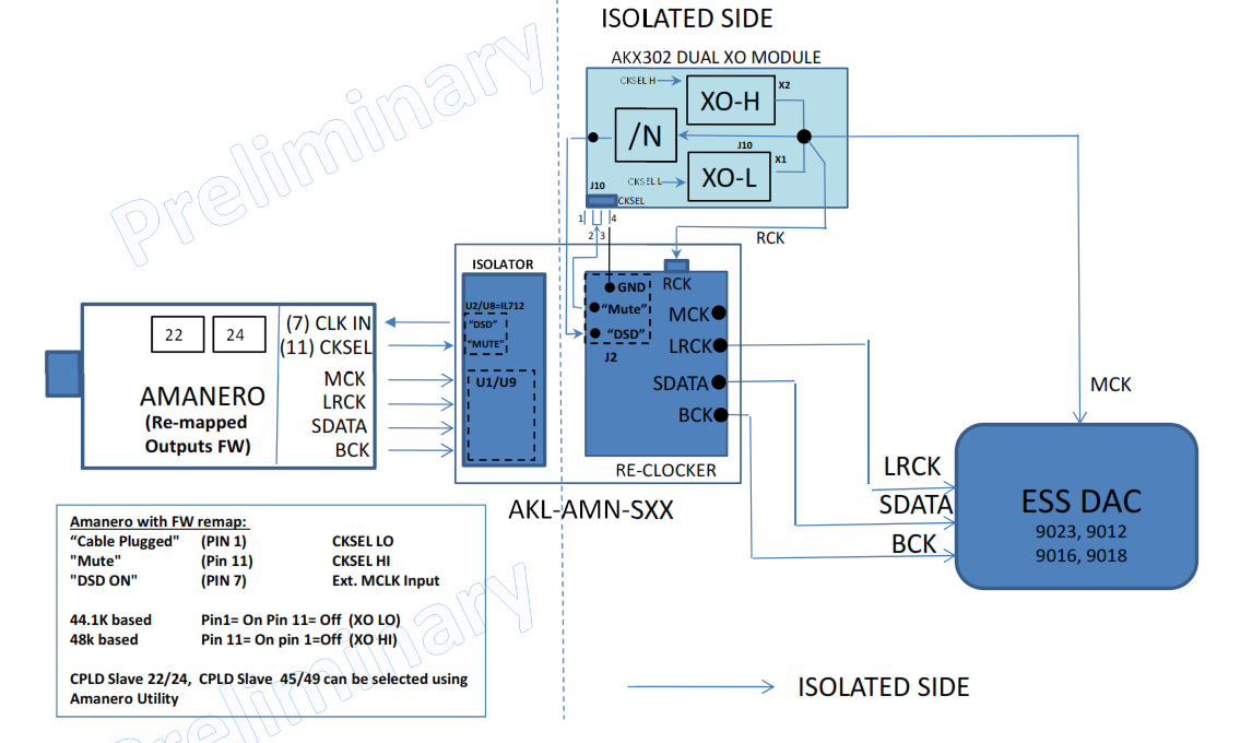

I fully agree with Stino that adding better clocks improves the sound quality very much but what I am trying to say in my earlier post is that for the first time one is able to make a fully synchronous setup with SOC and DAC.
Something like the following setup but with a bbb instead for the amanero usb/I2S.
- syncmode.PNG (184.55 KiB) Viewed 11472 times
That is what I am listening for now and I have to tell you that it is maybe the best sound I ever had in 30 years.
