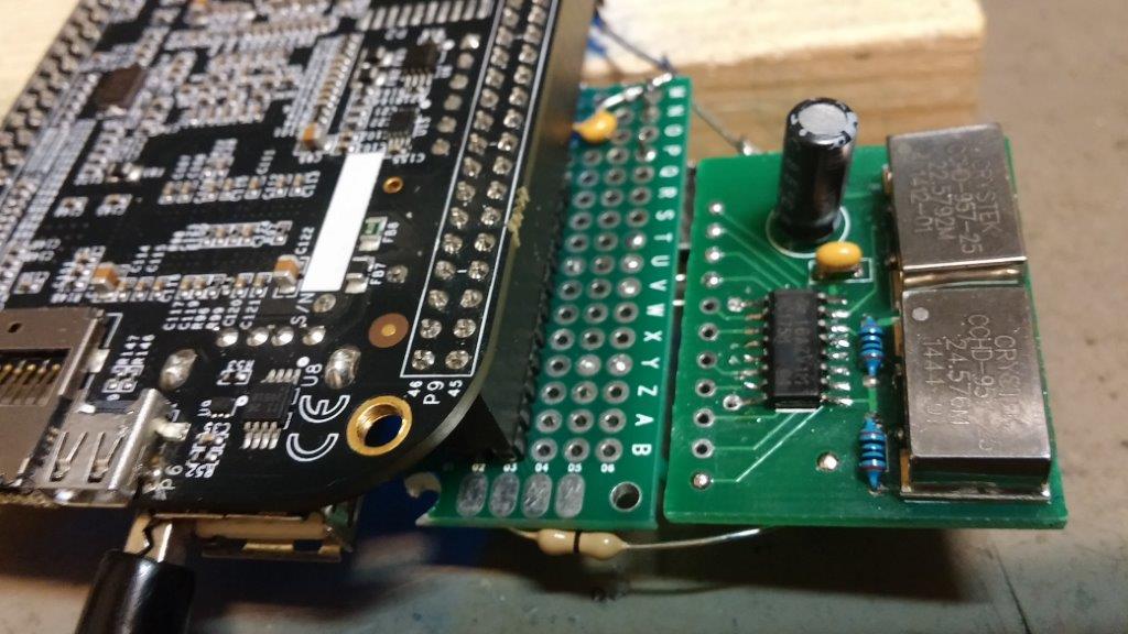

I made some prototype pcbs to test botic with external clocks and synchronous resample.
I received them yesterday.
Until now I have not connected the board to my DAC only made some measurements.
The jitter figures looks very promising.
Only one clock is activated for now until I have read some more how to activate the external clock switch on the botic driver.
I will come back with some feedback when I have listened some music. After all it is music all this is about OR?
