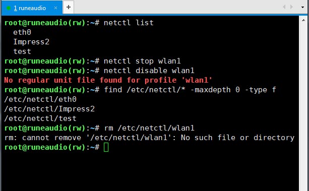

Hi janui:
It seems that wlan1 does not exist.
I spent 2-3 hours searching again: a start job is running for sys-subsy WLAN 1. device (1 minute 30s)...

Obviously (1 minute 30s) this problem has already arisen when off-board WiFi and Bluetooth are turned off.
You can try to replicate the problem by testing it on your device in my way.

Andre
- netctl-list.jpg (68 KiB) Viewed 1890 times
