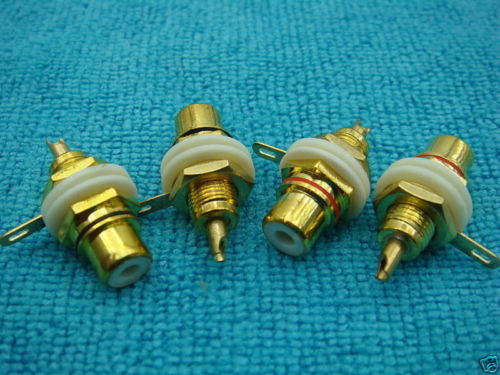

Another mistake I did was using RCA connectors without insulation. They were directly connected to the case. This may create a ground loop (you don't want that as you will hear a severe hum). Drill a hole big enough to accommodate insulated RCA connectors like these and make sure only the plastic is touching the case:
- !Bhg5BZgCGk~$(KGrHqQH-CgEsJzPJ,dhBLJc675!7g~~_12.JPG (46.16 KiB) Viewed 3780 times
