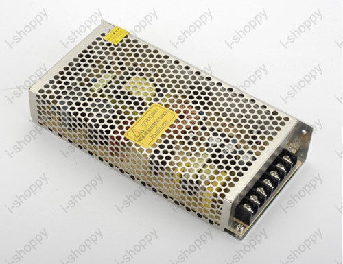

To power the TPA3116 and the Raspberry Pi, I would suggest that you get a suitable power supply for the TPA3116.
- SMPS-PSU.JPG (46.4 KiB) Viewed 7910 times
Something like this would be fine, 24 volts and 3-5 amperes. I would choose closer to 5 amperes, because you'll need to power the Raspberry Pi with this power supply as well.

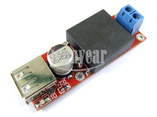

Now that you have the main PSU, you can get a
5V converter to power the Raspberry Pi. Choose the 3A version, to make sure that you have enough power for your Pi (it will not use all 3A, only somewhere below 1A). This version is great, because you can use a USB cable to connect the power to your Raspberry Pi. It connects to the 24V output of the larger power supply.
- 5V-converter.JPG (24.82 KiB) Viewed 7910 times
