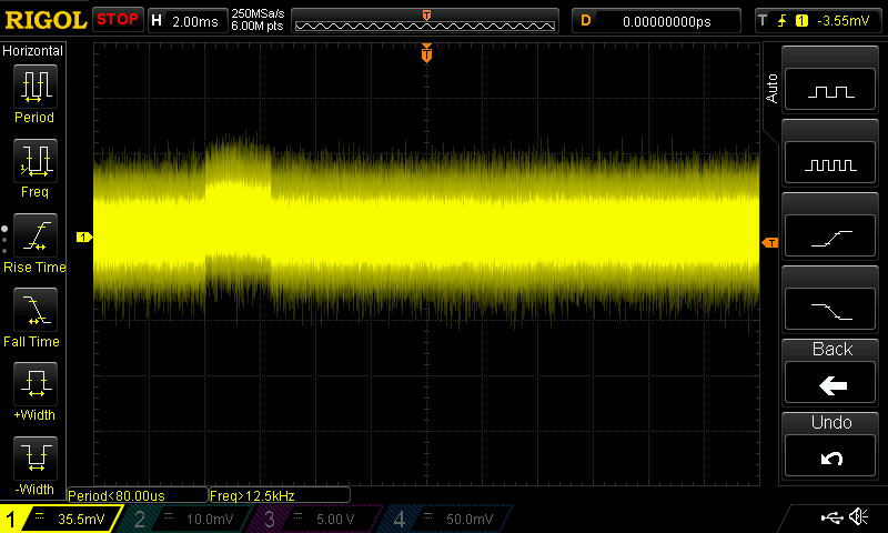

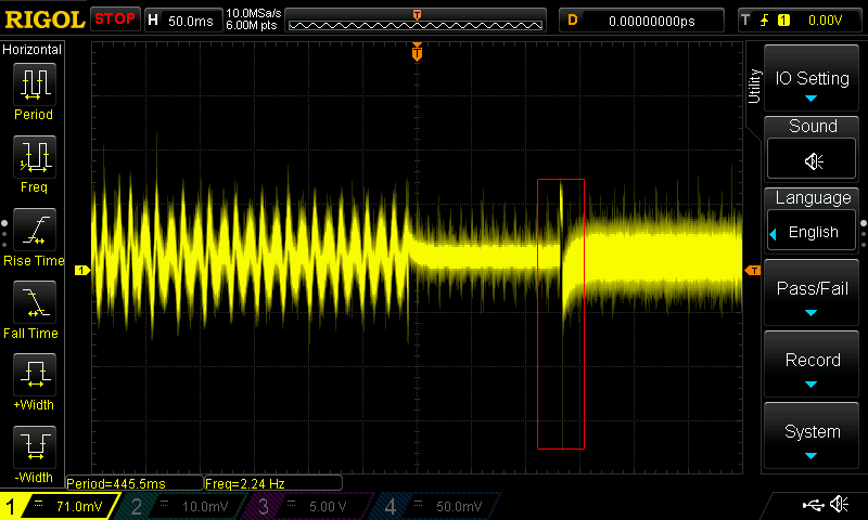

I guess the symptoms would be avoidable by getting the mpd to keep the music bitstream open and stream zeros or something like that (because I use 5 seconds of crossfade and there is just nothing hearable). But I don't know how to try this nor it could be done anyhow.
- Potential Problem? But where?
-> So: can anyone confirm same noise in his setup or found a way to fix it?
Attached you will find two measurements on my amp's output at 0 hw volume (1) and the other while playing music at a not so loud volume (2).
