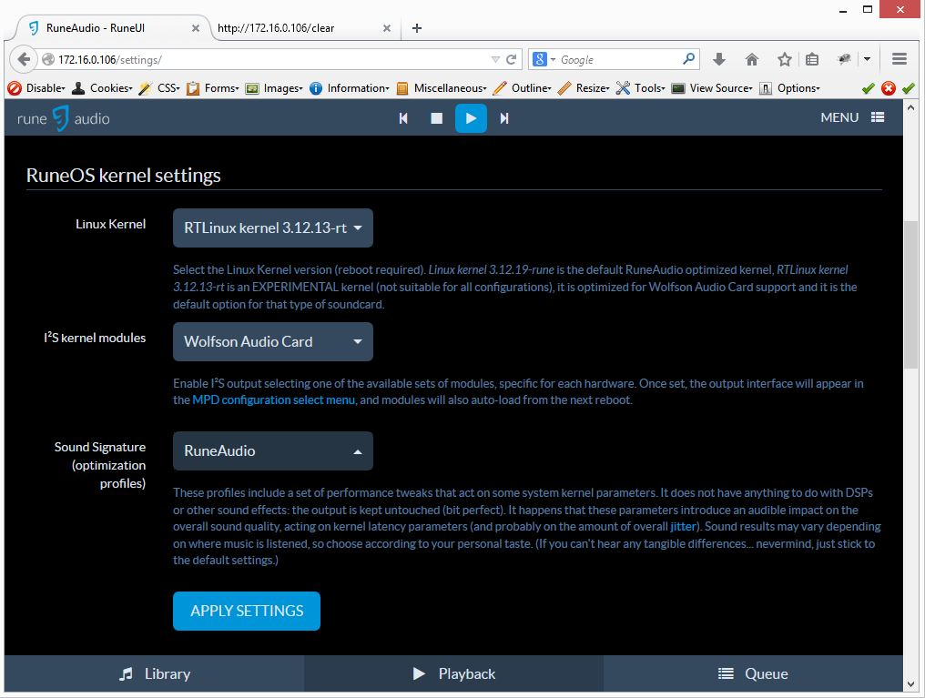

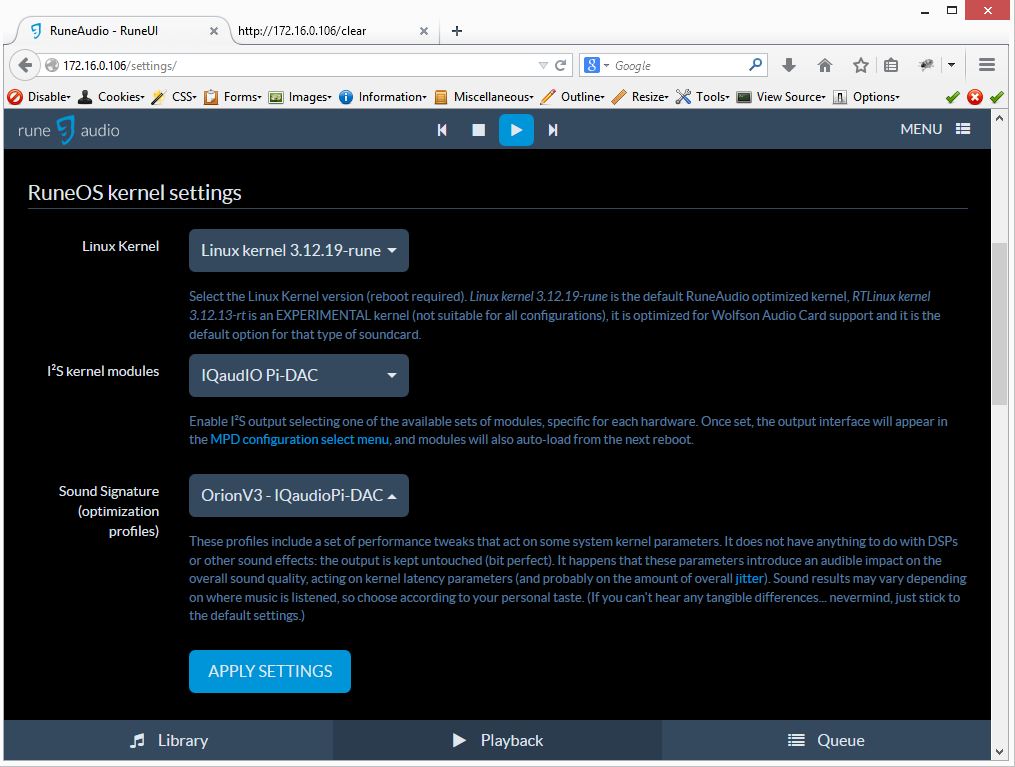

Ok, integrated, in v0.3.
Default settings for (with specific optimized, sound signature profile), default kernel.
Default settings for , RT kernel (thanks to ).
The attachment RuneAudio_v0.3-alpha_settings_kernel_selection_wolfson.JPG is no longer available

Postby gswg » 08 Jun 2014, 09:01
Simone, great work with IQaudIO Pi-DAC integration.
