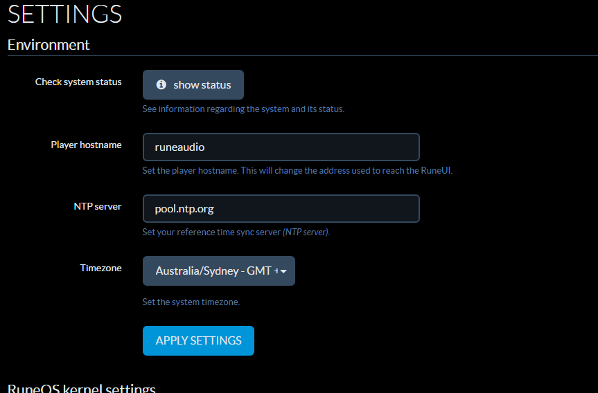

Hi Frank
I have...Australia/Sydney - GMT+10....it is Sunday 17th 8:08
