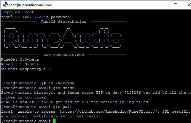

Postby foxint » 15 Apr 2016, 23:43
Thank.s - I have re-put on the software to the SD-card.
then I...
You can also try to update the system:
Code: Select all
cd /var/www/
git stash
git pull
This is what I did.....
Code: Select all....did not understand this - so I ignored it.
cd /var/www/....enter
git stash....enter
git pull...enter
This did not work....
Why do the most simple things fail ..... :cry: :cry: :cry:
So I am back to square 1...
The re-boot worked....yippie....
The power-off worked....
So from my understanding I have to pull the plug and then reattach???

Re: Turning the Software Off???
Postby foxint » 16 Apr 2016, 01:06
Hi Peter
Thank you....
Now I am concerend with the update process that did not work???
How does one update the software??
Postby foxint » 16 Apr 2016, 03:21
Sir
It did not work....please see my screen shot...
I am confused
Postby foxint » 16 Apr 2016, 04:06
Sir
Monday Feb 22 19:24;54:54 CET 2016
How do I change??
