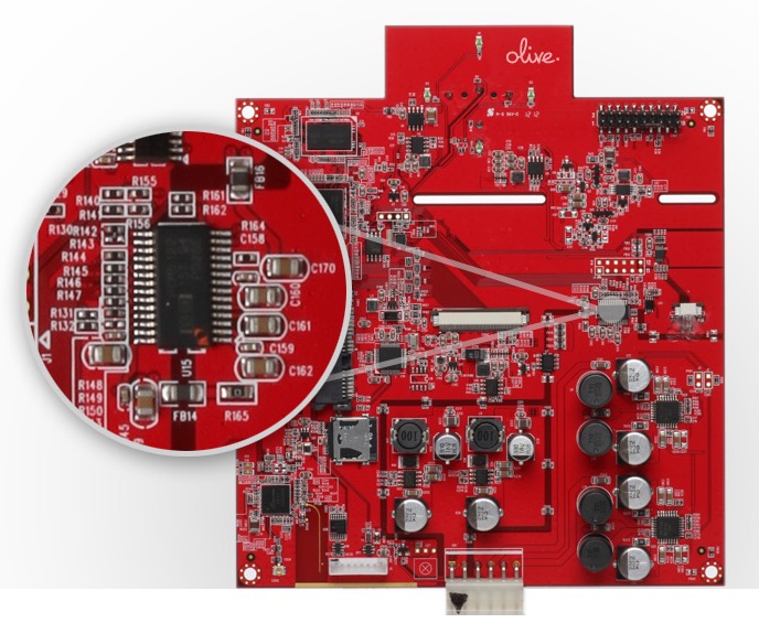

Postby Max. » 14 Jun 2016, 08:49
Inside II
Screen Shot 2016-06-14 at 09.49.06.jpg (132.21 KiB) Viewed 12926 times
Inside I
Screen Shot 2016-06-14 at 09.48.23.jpg (117.75 KiB) Viewed 12926 times
Olive ONE for sale
Screen Shot 2016-06-14 at 09.35.08.jpg (159.5 KiB) Viewed 12926 times

Postby Kidahl » 14 Jun 2016, 21:03
The file limit on 256 kB makes a hardware image a bit useless (lots of small text on the chips).
See here for a high-res picture:
https://slack-files.com/T1D6HPX2A-F1GTP4SBB-b919bf7962

Postby Kidahl » 15 Jun 2016, 07:22
One update that might be important; The unit runs libc 2.13 which is too old for the ARM binaries I have found so far (not Rune).

Postby jcueto » 26 Dec 2016, 23:50
I am looking for possible hack of the Olive One. So far I make some tests with the monitor and the touchscreen. The monitor is compatible with the 7" raspberry pi display. I may fit a RPi inside and make a player. Too bad losing the Olive one board, amp and dac.
