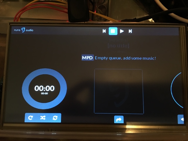

Does the current version: 0.4 build 20160313, support 800x480 screen yet?
I've got one with HDMI 800x480 and eGalax touch screen, the local browser seems still partially displayed (most of the volume tuner is out of the screen).

Hi flipphos,
there is definitively something wrong with your settings.
Rune Audio runs the local browser in full screen mode, so no matter what display it should fit the size.
For me it looks like your display is 640x480,
- what display are you using?
- please post complete /boot/config.txt

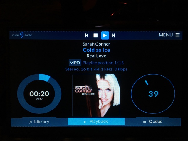

Screen adjusted.
IMG_2516_small after adjust overscan.jpg (71.78 KiB) Viewed 4465 times
