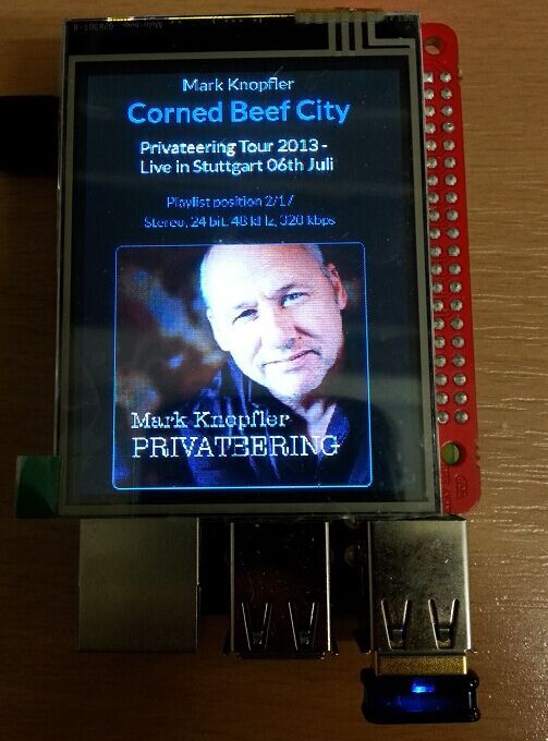

Equipment: pi2b + HDMI PC display = normal display - rotation OK
Question:
1. need to enter cache to clear http://myip\dev every other period of time?
2.default-encoding=ISO-8859-1 <-- Non English will be garbled.(>_<;)
3. Can use 3.5 inches LCD screen MODE PI2B in SPI?
4. this picture. Using the HDMI connection?
HDMI connection?
5. Can make the LCD screen not show "volume control"? Just like this one on the photo..
and don't stand up
HDMI connection?
